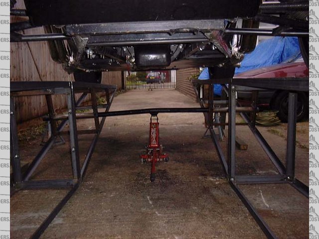

I Made these up.... Sort of reversed car ramps. (got the idea from some I saw on the Internet. However they were for silly money.
They work fairly well..
I had intended to be able to jack them into the Horizontal position. Whilst this worked OK, I wasnt too happy about the stability, and it definately needed axle stands or some better support other than just the jack under the cross beam.
I could have found a stronger pole, but I had that one lying about so gave it a try. Not too successfully.
In principle, the system works. but would need a little refinfing if used in the fully horizontal position.
I mainly just use them as in the first picture, whether with the car front or rear on. Works well, and is stable (as in the 1st Pic).
Hope this will give you some ideas.
EDIT:
Just read other post. I use a short chain and a shackle to hold the car to the top or the ramp (use the towing eye on car), so if the hand brake failed, The car wont go anywhere.
