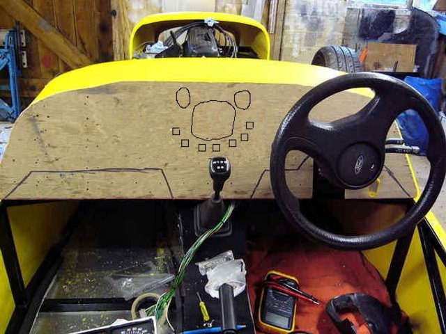

I've just started planning out my dashboard using the Sierra clocks from my donor. Now I know they are never going to look brilliant, but they
do work and they are free!
How have other people utilised tem and what re the rules regarding visibility from the driving position?

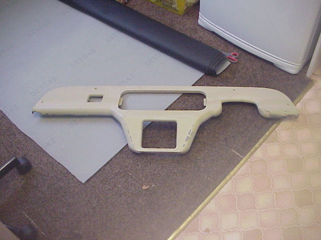

I'll try to post my dash - here goes -
![](/galpreviews/a153842-post-5-1098899309.jpg) ![Rescued attachment post-5-1098899309.jpg](/gallery/a153842-post-5-1098899309.jpg) Rescued attachment post-5-1098899309.jpg
Petemate
posted on 9/11/04 at 07:10 PM |
Eureka! It worked.
MDF, 12mm main dash, 7mm inst panel, routed at gauges. Plain vinyl inst panel, foam-backed main dash. 40mm waste pipe from B & Q, 15mm slot cut
out, for the lower radii, fitted over the bottom in sections, corners filled with P38. Front of dash at the bottom rebated to give the piping flush
fit.
Fairly inexpensive.
Pete(Oldgit)

Thanks for the kind comments. I'm going to try to post some more pics showing more of the construction. Here goes....
![](/galpreviews/a153942-MVC-807F.JPG) ![Rescued attachment MVC-807F.JPG](/gallery/a153942-MVC-807F.JPG) Rescued attachment MVC-807F.JPG

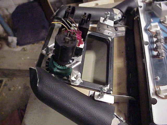

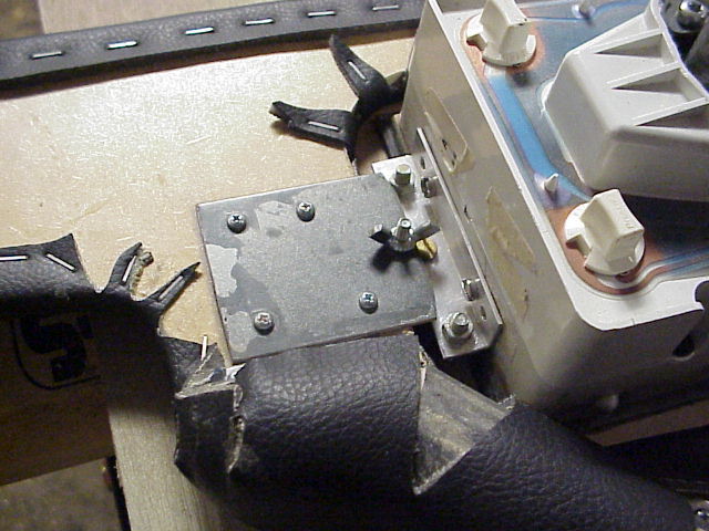

next - detail of inst panel QD fix
![](/galpreviews/a153943-MVC-819F.JPG) ![Rescued attachment MVC-819F.JPG](/gallery/a153943-MVC-819F.JPG) Rescued attachment MVC-819F.JPG

posted on 10/11/04 at 10:40 AM |
Hi Nick
Thanks for the kind comments. The pic of the uncovered dash was taken in the kitchen. Note, I sealed the MDF liberally with PVA, 1 - 1 to be sure.
Then once the P38 work was done, I applied some hi-build primer, and when that was rubbed dowm, a final coat of PVA, 2 water/1 PVA, to finally seal
and give a good base for the adhesive. I used Dunlop Thixofix, which although not recommended for vinyl, seemed to stick it ok. When I covered the
main dash, after sticking the front, I put it face down on the bench with heavy weights on for about 5 hours, and it ended up without any wrinkles. To
get wrinkle-free curves, I stuck the front by stretching it lengthways.
Pete(Oldgit)

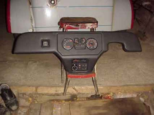

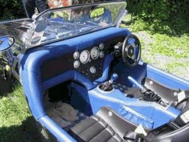

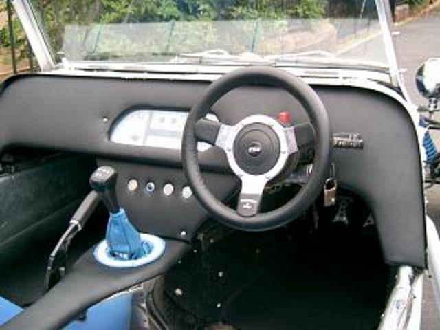

Andy - I'll see if I can post a couple of pics I saved from the RHOCaR site. One is based on the Sierra pod, with white faces, and the
"arc"-shape you mentioned. The other is based on the Capri pod, looking nice also with white dials - he has shaped his dash the other way
round from mine but the effect is what I'm ultimately looking for, i.e. like separate dials but at a fraction of the cost. (my Capri pod came,
E-bay, from the Lancs Capri centre - £10 plus £5 postage)
Petemate
![](/galpreviews/a154080-post-14-1099450655.jpg) ![Rescued attachment post-14-1099450655.jpg](/gallery/a154080-post-14-1099450655.jpg) Rescued attachment post-14-1099450655.jpg

Oh bother. Here's the other one...
![](/galpreviews/a154081-post-5-1099172387.jpg) ![Rescued attachment post-5-1099172387.jpg](/gallery/a154081-post-5-1099172387.jpg) Rescued attachment post-5-1099172387.jpg
