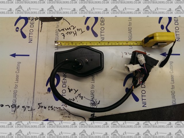

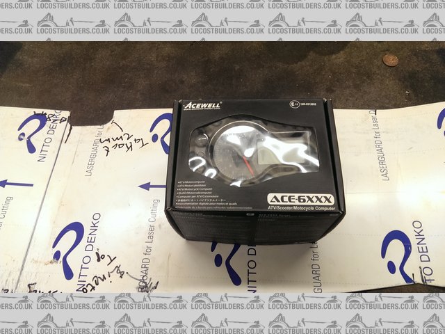

ceebmoj
posted on 11/9/14 at 09:07 PM Reply With Quote
Some photos of my ACE-64XX, it look better in the flesh. I would also recommend russbost as a suppler who was very helpful when I purchased a ACE-5859 a couple of years ago.
