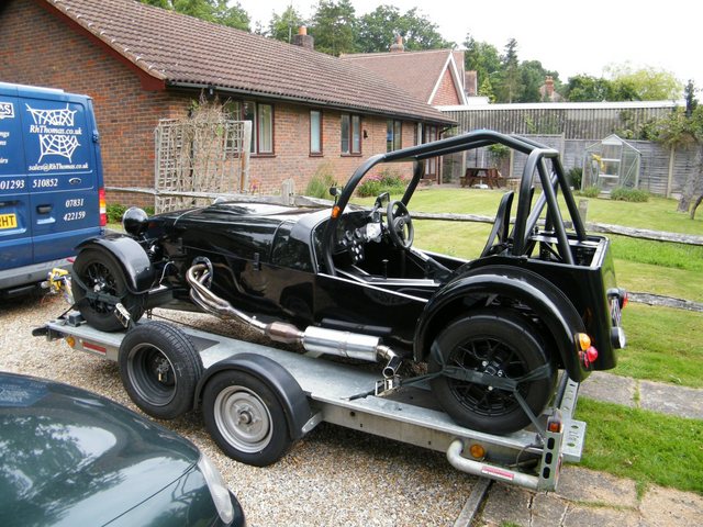

I have been looking at the Micro Max with the folding front arm so it will fit inside my garage
Renetom's MK Indy looks like a good fit on the Micro Max
