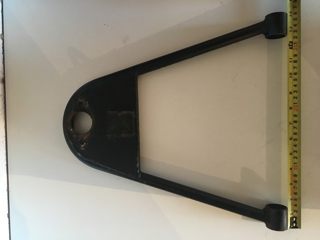

Afternoon all,
I need some help to track down a replacement front lower wishbone for my locost kit.
I have removed the old wishbone and measured the distance across the inboard bush tubes as 350mm (outside edge)
The books says 343mm and I have bought some rally design wishbones that measure 340mm
Does anyone know of any locost variant that ran the 350mm width? I thought I had a Stuart Taylor chassis but Aries tell me their wishbones are
340mm

Just a guess MK / Martin Keenen made some locost chassis he maybe able to help you
I know MK sold out but i mean Martin Keenen

Another vote for Martin Keenen.
And another.
See pic below, for comparison :-
![](/galpreviews/Luego_MK_WB.JPG) ![Old_Style_Wbones](/gallery/Luego_MK_WB.JPG) Old_Style_Wbones
On the left - Luego (I think); on the right - early Martin Keenan, for Locost-style chassis.
I replaced the wishbones, after reading the extensive thread about possible failures. I got some oval tube versions from MK.
[Edited on 12/5/17 by Dick Axtell]

Thanks very much for your replies guys.
I will get in touch with Martin, http://www.mkengineering.co.uk/ is him right?

That's the one.
He was still running MK Sportscars when I bought my MK Indy kit. Very helpful!
