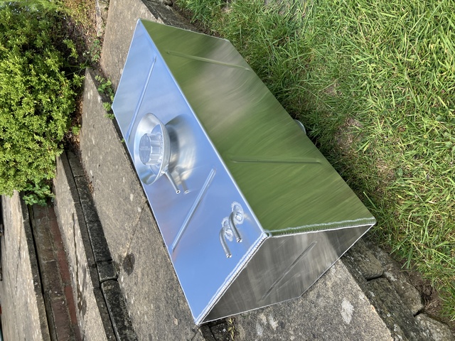

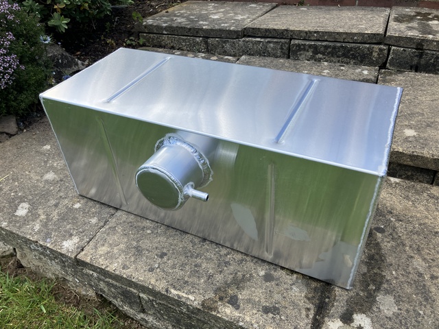

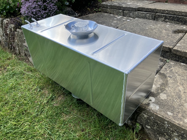

I’ve just bought a new fuel tank.
It was made to my drawing by Alloy Racing Fabrication.
I’m very pleased with it and here are some pictures for you…

Nice. Just over 8 gallons by my reckoning should give you a decent range. I don't see a fuel guage fitting; any reason not to have one? Did you put internal baffles in it?

Yep just over 8 gallons
It has internal baffles and the Sump is capped
No fuel level sender simply because I didn’t have one before and it wasn’t a problem

Looks good and well made. The splash guard is a good idea. Think I'll copy that when I need to replace my plastic MAC#1 one and have the filler cap on top of the tank, rather than using a flex pipe and filler on top of the rear deck which always takes an age to fill.
Thanks for posting.
