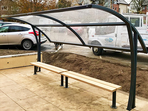

If i've understood correctly, you want something like a football dugout with just two posts behind those seated, one at the start and one at the end to hold up the roof. Which will cover 15 people. Assuming each person when seated takes 0.75m to be comfortable in a folding camp chair you're looking at a run of approx 11m for just two posts to support. This seems like a lot.
Quick google got this which doesn't quite fit the bill being translucent and with the intermediary posts but is it close to what you're thinking if it had a shade generating cover?
https://www.shelters4less.co.uk/Shelters-Walkways-Canopies/Waiting-Shelters/Derby-Open-Fronted-Waiting-Shelter
steve m
posted on 1/7/25 at 09:29 PM Reply With Quote
Yes, along those lines
