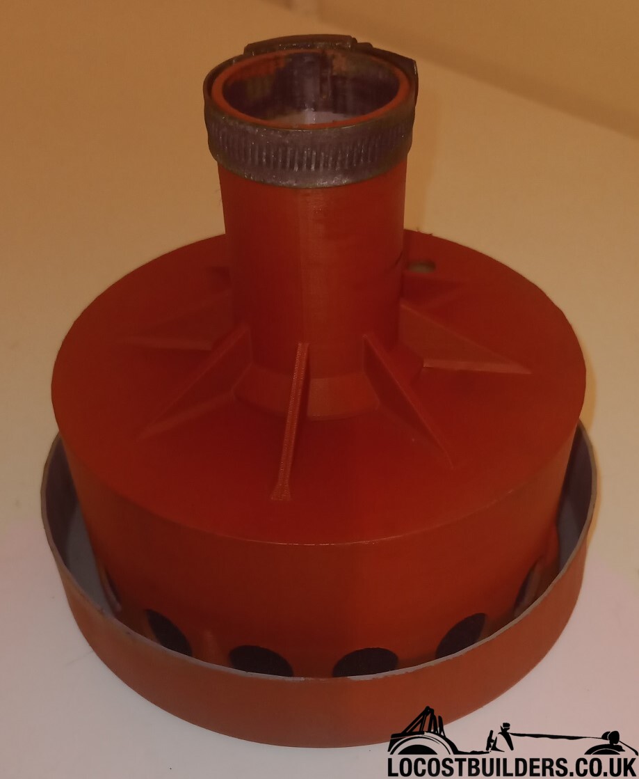

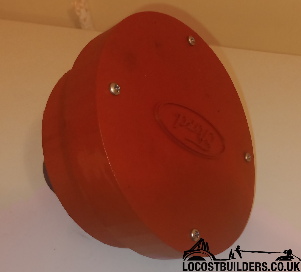

Hi,
If you remember back in April I experimented with a 3D PLA air filter for old car. This was run off from some spare filament I was using for the ships as I was concerned about not having a filter on the car and original metal ones are super rare and very expensive. Some were sceptical if standard (cheapo) PLA would last in a hot engine bay, the carb being directly above the exhaust. However after a lot of use over the last 7 months and the hot summer, I can report that the filter has not suffered in any way. Nothing has melted, warped or cracked, indeed it just looks the same but a bit dirtier (yes I sprayed it with red primer at the start as the grey stood out). It's performed great removing my concern when stuck behind a dumper truck etc and has reduced the engine roar dramatically. I haven't cleaned the foam filter, there's so much of it in there, only oiled it now and again.
So yeah PLA in an engine bay, seems to be fine (if your sensible)
As is just taken off the car -
[Edited on 19/12/25 by Mr Whippy]

posted on 19/12/25 at 09:39 PM Reply With Quote
Well I did say if you are sensible. I had already measured the temp it got after a good hard run and it was perfectly within the limits of PLA. There's actually a lot of ventilation and space in the engine bay. I'm not saying that PLA is the best choice as I think PETG would be better but I don't have any at the moment. However if simple PLA works here, just think how many applications are possible with better materials...
