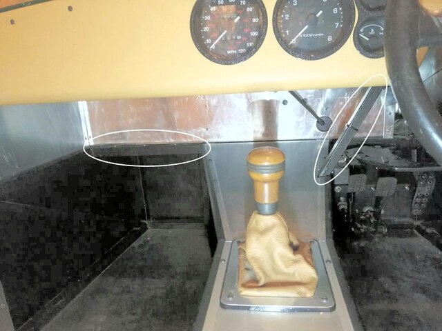

I have two chassis members that are a bit 'visible', and I'm wondering what to do with them.
[img]https://blogger.googleusercontent.com/img/a/AVvXsEi_oP8zfCTrtF38KIG9iTfysIK60iKh5sZXctNrX4dLwZZvSo899VyU1IBrcZ5KaLKXRHjPq6KakwNRaW5p5Ajknh2i2wY5Z o_WVqvJVwowtlQ8hwdelVop0T8Nx7y3EsscJnhjWF6N1JZIPcjJLixy44YxuCOLPSOXXVui-sdkbjOZTE0pTPyuwWqTZcA[/img]
(Hmm, images still not working..., try This)
The horizontal one within range of the passenger shin is TR9 off the Haynes plans, the one supporting the steering column is SW3. Both appear to be within the specified zone, and I think my 'skinny' dash means that they're more exposed than on a normal Haynes build. They are radiused just from the natural curve in the metal, but should I add something more just because of where they are?
[Edited on 19/1/26 by Slimy38]
this one looks to have a couple of studs in the lower edge, I would cover that in carpet, and in-fact you could go from there to the bottom of dash panel in carpet.
the next stage would be a hole in the dash, and utilise the space as a 'glove pocket']
Slimy38
posted on 19/1/26 at 03:58 PM Reply With Quote
Ah, it probably doesn't help that the picture is quite dark. Those aren't studs, they're where the aluminium rivets to the cross member below. So those 'studs' are actually on top of the painted-black cross member!
Overall though I think you've confirmed my fear, it does need a cover. I've got myself some black faux leather and I'll make a pad to go over the metal.

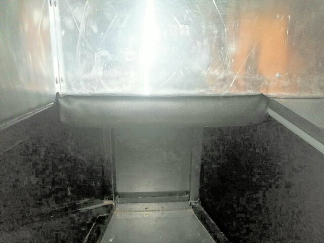

I have enhanced the pic. I see what you mean for studs,
footwell enhanced
footwell enhanced

Excellent, I was really struggling to do anything with the picture and using a flash for a new picture just reflected off the aluminium. That shows the black cross bar a bit clearer now, thanks.
To be fair I've actually tried to hit it with my shin and it's not physically possible unless you've already travelled through the dashboard to get there. And if that happens there's more things to worry about than a bruise or two. A passenger putting their feet in there can't 'kick up' as it's solid behind the metal.
The steering column support is more of a practical thing though, depending on how the driver gets in you can slide your legs either side of the wheel, in which case you 'could' (if you're very clumsy) bump your knee against the support. Again, during an accident you've got a steering wheel and dashboard to cause injury long before you get to the support.
As with everything IVA related though, I see the rules as a 'fixed point' that can/should be applied to every variation of every car out there. Just because mine needs a contortionist to injure themselves shouldn't mean I choose to exempt myself from some of the rules.
