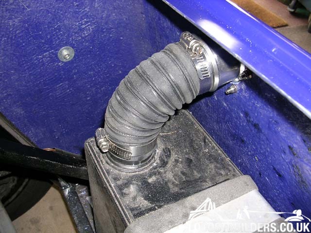

I'm having some trouble with my filler pipe, it was just a bit 'pongy' before but now it's just a full on tidal wave whenever I fill the tank up to the top. The tank is a self-built one with a 2 inch pipe on the exit, about an inch long. I'm trying to use CBS's flexible fuel filler from here https://www.carbuilder.com/products/ultra-flexible-fuel-filler-hose-51mm, but I cannot get it to seal on the pipe.
First attempt was a jubilee clip, that didn't seem to help. Next attempt was with a spiral wire clip, that didn't fare much better. At the moment there's one of each and I still can't get the required amount of fuel to stay put.
I was thinking of some sealant or similar between the filler pipe and the tank pipe but I don't know what. I toyed with the idea of PTFE tape, a quick check online suggests I'll just end up with PTFE fibres clogging up my filter and the rest of the system. My brother in law has suggested a section of bike inner tube rubber over the pipe first, again I'm at the whim of the corrosive substance we call 'petrol' nowadays.
Is there a knack or technique I'm missing that would seal the pipe to the tank? It's definitely the seal between the two, fuel is now visible as I fill it up. To be honest I'd have preferred it if it was a failed weld, at least I can fix those.
Frustratingly my 'non-IVA compliant' filler pipe was perfectly fine, stupid me swapped it for the CBS version and disposed of the old one because I didn't think I'd need it anymore. Neither of them had marks, I have an IVA declaration from CBS to say theirs is compliant.

I should add the pipe is a snug fit, not so tight that it needs soapy water to fit (like a fuel line), but snug enough that I have to make sure things are perfectly round and aligned before it will slide on.

That is odd. From what you've written I can't think of any reason why the pipe you are using should leak with either of the hose clamp options or indeed without a clamp at all as there is no pressure.
Is it possible that there is actually a leak where the metal pipe spigot joins the main tank? As it is only 1" long I'm guessing the hose goes right down to the tank so the leak would be visible in the same place whichever?
I know you say it didn't leak before with the non IVA compliant pipe but its possible the act of removing that pipe and installing the new one could have stressed the metal to metal connection and made a leak there?
Yeah the hose butts right up to the wall of the tank so what you say makes sense, I really shouldn't discount a metal seam leak. I'm going to try and mount the pipe away from the wall with maybe half inch gap, just to confirm which side it comes from.
The problem is the pipe is on the side of the tank rather than the top, so when the tank is full I have static fuel in the pipe. I had to come in on the side due to where my filler cap is on the car (that can't be moved).

I believe you need to present the vehicle at IVA with a full tank so definitely needs fixing!

Yep, that's what drove me to this point in the first place, I've been adding five litres every so often until the tank shows full. It would be so much easier if it could be presented with half a tank, but I understand why they do it. It's to highlight issues like this.

The seam in that pipe is going to be pretty suceptible to fuel wicking through it, as I don't think it looks compressible enough to close off the seam completely with just a plain clip.
You're either looking at using a compatible non setting sealer to bridge the gap left when the clip is tightened, or a curing polysulphide based sealant suitable for continous contact with fuel if the remaining gap is too large for a non setting sealer to work.
Something like Wellseal for a non setting sealer, for a curing type something like a small amount of slosh tank leak sealer could be used, polysulphide sealants are a bit specialist and difficult to find in small quantities.
I have used sikaflex 221 pu in contact with fuel in a pinch, but it goes somewhat soft/mushy where in contact with fuel and hardens/dries out on external facing areas, so probably not suitable for your purposes.
My only other thought is in the vein of your BIL suggestion, but place a thicker rubber band (like a coolant hose section) over both the pipes as assembled and use the pressure of a jubilee clip (or for more pressure a mikalor type hose clamp) to create enough pressure to compress the area around the wire tighter (as it will mould around the uneven shape), with the rubber on the outside it is not exposed to any fuel so shouldn't be a problem for iva.
