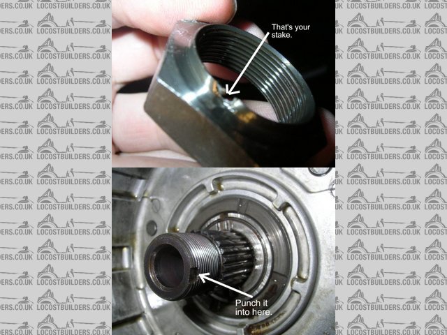

Been breaking more stuff inside my clutch..
There's this inner basket which takes the 5 bolts for the springs. This basket is fastened to the big shaft which goes to the gearbox, via a big
retaining nut. The nut is locked in place with some "stake" (according to the Haynes manual). I don't know what this stake is but now
it's very important for me to know because I took the nut off, breaking any stakes. Result, the big threaded shaft is nice and clean with no
stakes (takes a new nut smoothly), and the old nut was damaged when I took it off.
Can you take a look at the pics and tell me how in big sh1t am I? Will I need to replace the big shaft or what?
Alex

Petemate
posted on 28/6/05 at 08:11 AM |
Hi Alez
As far as I can recall, this is the normal method on Jap bikes of retaining the nuts for the clutch. The shaft is hardened, and the
"stake" area, i.e. the collar which you stake into the groove, is mild steel. Therefore when removing the nut, virtually no damage is done
to the threads, and you can fit a new nut and stake it as before. Same method is used on, for instance, the drive shaft outer nut on most Escort
variants. I always dig out as much as possible of the deformed collars in these applications to reduce the chance of any damage, but have never
encountered damaged threads on the shafts over the years.
HTH
Petemate
posted on 28/6/05 at 08:13 AM |
The stake is the locking mechanism on your nut Alez. It's best to tap it out with a punch (screwdriver ). If you use a new nut you tap the
thin edge into the cutout on the shaft to lock it. You shaft looks fine.

ChrisGamlin
posted on 28/6/05 at 10:27 AM |
All looks fine to me too Alex, just get yourself another nut from the Honda dealer

posted on 28/6/05 at 10:31 AM |
Cheers Chris, I got the new nut already and goes very smoothly (by hand) into the shaft so I've not damaged the shaft thread at all!
