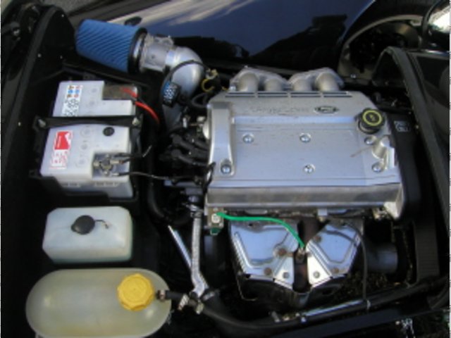

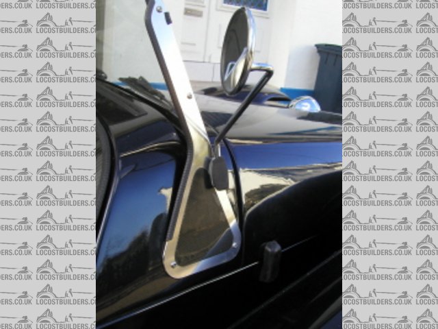

Possibly check radius on windscreen uprights, bootlid hinges
