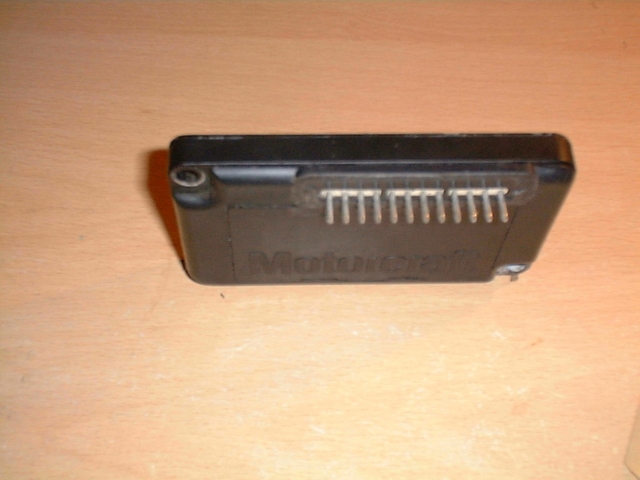

How the hell has he stripped the edis4 its in an injection moulded case covered in a layer of jelly like stuff and then has a cover over this ?

Just looked at it , it is a custom made board not the original megajolt board and has no programmable outputs, shift lights or hard cut rev limiter.
He says that he partially dismantles the Edis unit i assume he cuts the plastic away by the connector pins and then solders it to the Pcb using the original pins.

I experimented with an Edis today. First i cut the plug mounting off and it leaves a neat module with the pins for connecting to which i think could be incorporated into the megajolt box quite easily .

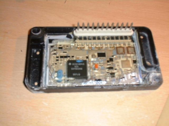

I then drilled out the cover fixings and found the insides to be totally unsuitable for further dismantling.It is covered in jelly that I assume protects from damp and disperses heat , there are also what looks like two output transistors with no case , ie surface mounted with the connecting wires sealed only by the jelly
and no isulation on them at all.
What would the demand for basic megajolts with no programmable outputs or shift lights etc be ? I could build a budget version that only does ignition control and software rev limiter but havent persued the option previously as i assumed most would want all the options.
Paul.
[Edited on 28/2/06 by paulf] Rescued attachment cut down edis.JPG
