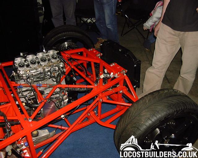

I think that all of the MNR vortx chassis are now round tubing, I know my RT+ is, but I'm not sure on the RT. I don't think the MK chassis
is round either.
5k with an R1 engine would build you a Vortx RT, but you'd be cutting corneres and not buying the nicest of everything.

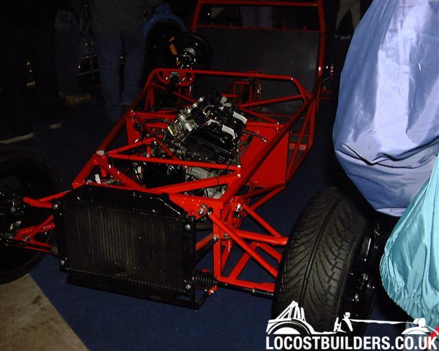

The one I,m building is all home built, using an 893 blade engine for emmissions.
Mostly round tube chasis and as many ali panels as I can get as weight will be key with a low power unit.
So far cost is £3k and I can lift each end seperately with only a few pounds in weight to add now.
If it cannot make a sub 4sec 0-60 when its finished I,ll be in tears .
So far 6 months of 1 day a week... its a lot of work, you may be better off scanning Ebay for a bargin and changing out the engine.

You've mentioned using all ali panels to save weight, but if I can make a suggestion you may want to weigh your wheels (if those 18" (?)
are the ones you're going to be using?) and see how much you'd save with smaller 13/15" rims. I suspect you'd probably save
more weight there than all the ali panels put together, and especially as its unsprung and rotating mass, it may well be the difference between
hitting your target or not.

The wheels in the picture are just for pushing around on, they are on Ebay now. I have a set of 13" minilights which are going on (much lighter
although the rear brakes are now an issue).
