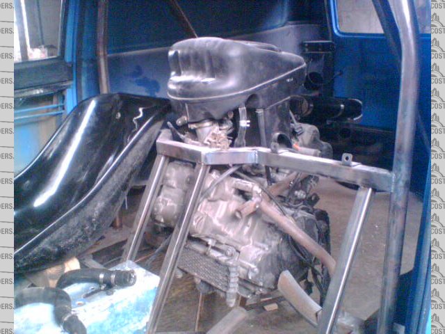

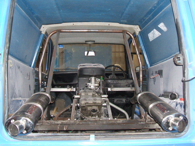

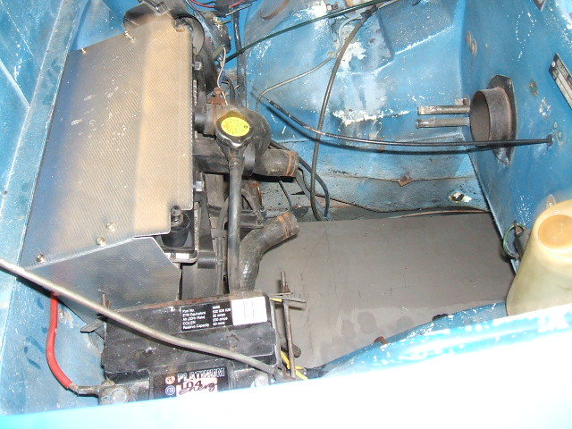

posted on 22/7/06 at 01:34 PM |
mine is a tl motor and makes 120hp with 85lb/ft .apart from what it looks like the kitten has some advantages over the mini from a builders point of
view, first its a shed load lighter to start with ,a stock mini is around 750kg where the reliant van is 515kg ,its rear wheel drive with double
wishbone front end and the fuel tank sits under the radiadtor between the chassis rails unlike the mini where it gets baked by the radiator. mine
still sits on 10" wheels which gives it at least a 30kg advantage over a 13" setup . if my sums are right it should be around the 460-475 kg
mark which is pretty much the same as most bec,s but i stay warm and dry
[Edited on 22/7/06 by froggy]
![](/galpreviews/a406331-smallpixel 001.jpg) ![Rescued attachment smallpixel 001.jpg](/gallery/a406331-smallpixel 001.jpg) Rescued attachment smallpixel 001.jpg
froggy
posted on 22/7/06 at 01:39 PM |
the tl is pretty tough but the gearboxes arent that strong so ive made a chain drive unit just like a go kart using the centre of the bikes rear wheel
to retain the cush drive il post pics once i get the the lobro flanges back for it.
xzr id think about weight more than anything and deffo go for chain drive as if you go for prop and sierra diff you will have the same gaering probs
that other becs have unlike chain drive which you can change to suit the engine .
![](/galpreviews/a406332-smallpixel 003.jpg) ![Rescued attachment smallpixel 003.jpg](/gallery/a406332-smallpixel 003.jpg) Rescued attachment smallpixel 003.jpg
froggy
posted on 22/7/06 at 01:43 PM |
its a good plan but its a lot of work ,but its an all year round car and mine will be 240bhp/tonne and 300bhp/tonne once the nos kit is
fitted
