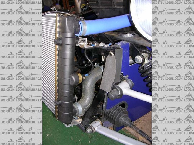

Jonte
posted on 29/3/08 at 08:17 PM |
quote: Originally posted by Stuart_B
hi Jonte, have you got a picture of the mk rad?
thanks
stuart
I do
![](/galpreviews/fan_zetec.jpg) ![mk rad](/gallery/fan_zetec.jpg) mk rad
Click it
Stuart_B
posted on 29/3/08 at 08:57 PM |
thanks, i know what they do now.
