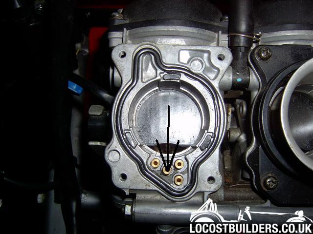

i have just ordered one of these from andy..he told me to block off this one and to make sure the little brass coloured take off tube on the 3rd from left is all well blocked off...
He is a top bloke and recommend him highly...
[img]http:// [/img]

Im pretty sure it doesnt matter the carbs i think are the same(ish) mine is a 97 (919) i sure for this part of the dynojet kit it doesnt matter
