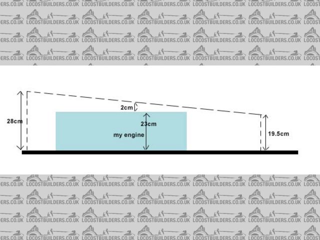

G3OFF
posted on 20/8/03 at 07:07 PM |
Here you go.... its a ruff drawing but should help... hopefully
dotted line is the bonnet by the way
[Edited on 20/8/03 by G3OFF]

ChrisW
posted on 20/8/03 at 09:14 PM |
That's different to what Grant told me! Guess I'll assume worst case scenario and go for 250-195mm
Chris

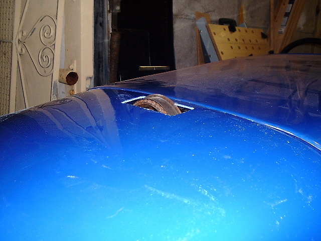

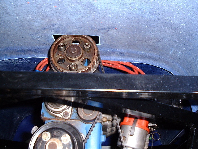

That's what I'm doing. Got myself a a book Luego chassis, and I'm squeezing in a Pinto and type 9, along with standard fibreglass nose
and scuttle. I'm sure you can imagine that it's not all going to fit without something poking out!
I've determined that with 4 inches of ground clearance, and a relocated oil filler, I can get away with a 'small' bulge over the cam
pulley only, perhaps even smaller if I machine the cam belt backing disc down to size.
May have to modify my RS alloy sump by an inch though.
We'll see...
![](/galpreviews/a53005-DSCF0114.JPG) ![Rescued attachment DSCF0114.JPG](/gallery/a53005-DSCF0114.JPG) Rescued attachment DSCF0114.JPG
Sparky
posted on 27/8/03 at 05:36 PM |
And from the underside...
![](/galpreviews/a53006-DSCF0115.JPG) ![Rescued attachment DSCF0115.JPG](/gallery/a53006-DSCF0115.JPG) Rescued attachment DSCF0115.JPG

It'll be interesting to see how much movement your engine has at those times when revs drop and it vibrates a bit on the mounts...
Cock off or cock on. You choose.
