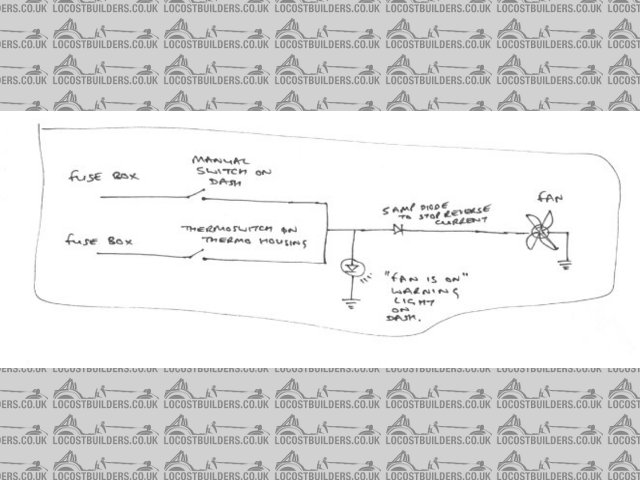

Hi, hope your investigation is going well. The reason I thought about reverse curent is because of the set-up I've got, I've attached a
picture, I know yours is different but it may help. Sheepy

Sheepys; solution should work for either LED or lamp..I should have drawed it out meself...I wus finkin the LED would be in series with the fan and of
course its in parallel (muppet !)
