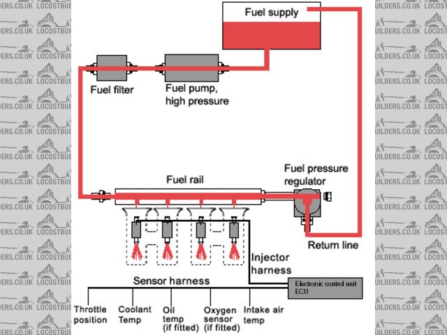

fuel system diagram
does anyone have a nice simple diagram for the fuel system for an injection car as in returns and feeds, breathers etc???
westcost1
posted on 25/10/07 at 11:44 AM |
I also have a filter before the pump and one on the return as well. Breather in the top of the tank got it of ebay for a cuple of £ they fit on mini
motor bikes look like a top hat with a ball baring in
[Edited on 25/10/07 by westcost1]
![](/galpreviews/a636925-fuel_inj_system.jpg) ![Rescued attachment fuel_inj_system.jpg](/gallery/a636925-fuel_inj_system.jpg) Rescued attachment fuel_inj_system.jpg

just out of interest, why is the filter after the punp and not before?
westcost1
posted on 25/10/07 at 03:15 PM |
other people on here recommended using the breather should be ok it doesn’t let liquid out when its turned upside down. I think the diagram assumes
there is a filter in the tank ?? but there should be one after the pump to stop any thing from the pump getting into the fuel rail
