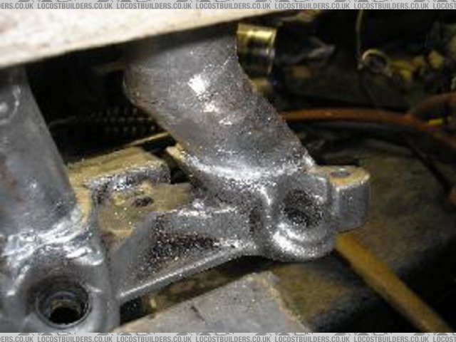

Stuart_B
posted on 26/3/08 at 03:31 PM |
Hi all, i recived the rods today so i am going to have a crack at making my manifold today.
i post up some pics once i have done the welding.
stuart![](/images//smilies/smile.gif)
Stuart_B
posted on 26/3/08 at 09:11 PM |
Here is mine go at it.
![](/galpreviews/a715368-2.JPG) ![Rescued attachment 2.JPG](/gallery/a715368-2.JPG) Rescued attachment 2.JPG
