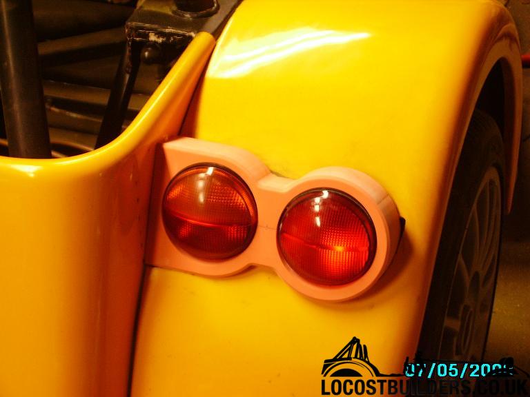

New Rear Lights cluster (CNC milled) HELP NEEDED
Opinions please...
Now i need some tactics to complete it...
i was thinking, sanding.... glue, screws, filler and respary to black??? (want it yellow but will be difficult not??
Tks
[Edited on 23/6/08 by tks]

If you know the RAL code of your gelcoat, you should be able to get yellow paint to match your body....
tks
posted on 23/6/08 at 08:25 PM |
its standard melon yellow..
but i hear that it never can match exactly..would it be visible..??
any tips on the filler / tricks needed to finish off....

Looks nice..
stevebubs
posted on 23/6/08 at 08:30 PM |
Getting an aerosol of the right yellow shouldnt' be that expensive, and if it doesn't look right, you could still spray it black...
stevebubs
posted on 23/6/08 at 08:32 PM |

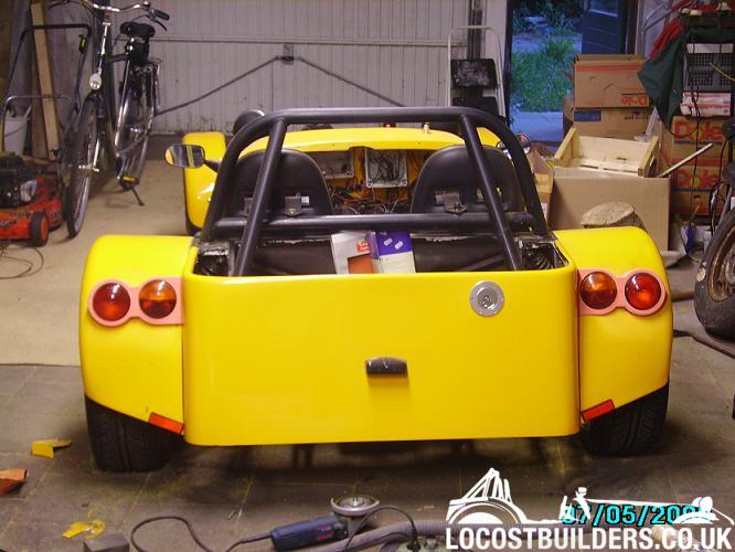

only (constructive) criticism I would make is that they look like they're pointing down (forming an inverted "V" but that could be
a trick of the camera.
tks
posted on 23/6/08 at 08:38 PM |
yupsz.. thats well spotted...
the inner holes are 2,5mm higher... then the outer ones...
i'm thinking that i might put the brake and pos on the inner holes and the indicators and fog on the outer ones...
better???

That would probably help - I'm not sure the indicators would pass SVA in their current location.
Think the inverted "V" is emphasized by the lower edges of the arches, though - doubt it would be noticable if the lower edges were
level.
Nice work, though

The lenght of the complete cluster is 255mm...
the rule is 350mm so i hope they do..

Luego melon yellow is RAL 1028, i got a half litre can mixed up at the local paint suppliers for doing some of the donor bits to match my Melon yellow
bodywork, its a pretty spot on match and for a few pounds more, they will also mix up aerosol cans if you need them.
Im going to mix it to use in the compressor but thought afterwards that i should have got one aerosol made up from the batch just for those touch up
jobs..

I like the shape and think that yellow would be best?? It be v cool if you could use filler to blend them into your arches though might be difficult
to paint. Just a thought but maybe the indicators would look better on the outside??

I am planning to make up a mount similar to yours, but I am going to GRP it all togehter before spraying the whole lot. I like my lights, but they
would stick through far too far into the wheel arch if surface mounted. Your solution looks very neat. Thumbs up from me!

today i also filled the back line up with more of the same shape...
it looks even better now...
will make some shots..when its a bit further to the end...
