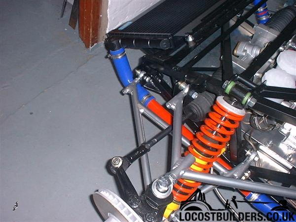

Ferg
posted on 15/7/08 at 09:11 PM Reply With Quote
Any use? I'll find a better one if you like.

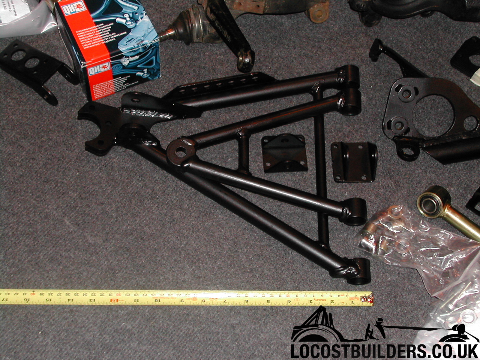

JC
posted on 16/7/08 at 10:52 AM Reply With Quote
How about this? GTM wishbones and metro uprights in a terrapin. Guess they do have bolt on arms! I am in Canada at the moment but will check the ones I have when I return!

andyps
posted on 16/7/08 at 04:02 PM Reply With Quote
Any idea what the top rose joints are - just wondering how they cope with the taper on the Metro ball joint.
Andy

Ferg
posted on 16/7/08 at 04:21 PM Reply With Quote
No idea. Those aren't GTM wishbones.
The bottom pic shows some Libra fronts and a few bits of Libra rear.
