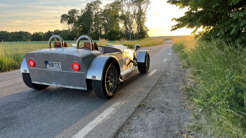

Here is one of the latest pictures of it. I have added the rear view mirrors after this and I am now hoping to add the headlights and front indicators in the coming week and that would pretty much be all the "must haves" for the swedish registration done. I hope to have it road legal before july if all the inspections goes well. The rolling chassis inspection was completed late 2020, left to do is the complete build inspection by the Swedish self builders association, noise test and then its due for a normal registration inspection.

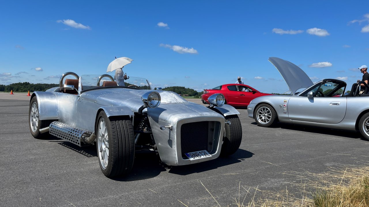

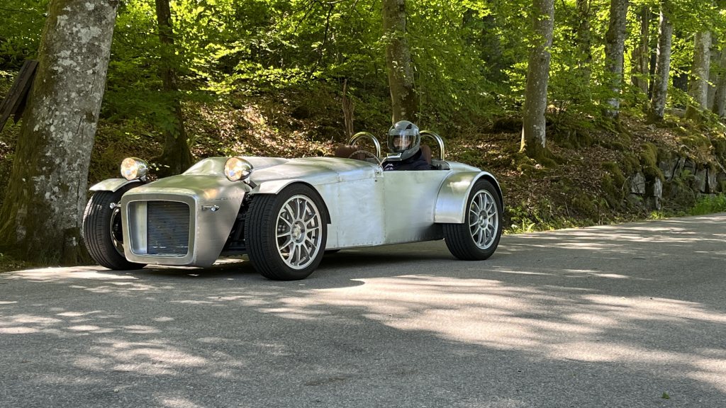

Back in the end of May the build finally got roadlegal and I could start using it. June weather was awsome but almost too dry for our farmers and nature and then July was very windy and lately we've had alot of rain like most of Europe.
Despite the weather I have driven about 1900 km's (1200 miles) so far and worked out some bugs and found things that needs to be fixed.
The left front wingstay sheared off around the 1000 km mark where the tube transitions to the flat bar, so both sides was reinforced. I will remove the flat bar entirely as soon as I get some tube bending done.
The headlight brackets cracked, they will need some redesign but they are welded up and ok for now.
The newly overhauled Sierra diff started leaking that will need to get fixed during winter.
I have also added a windscreen, it was way too annoying to even drive. Over 50 km/h you needed goggles and over 70 you really wanted a helmet and that reduced the joy of driving too much. With the windscreen I can cruise at 90 km/h with only a ear bud in my left ear to remove a bit of vind noise.
