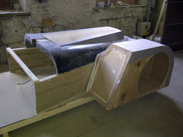

Carbonman
posted on 2/8/13 at 07:39 PM |
The floods on Monday left me with quite a bit of damaged equipment the Curing Oven being the main thing. So whilst things are being repaired or
replaced I thought I may as well make a start on the full scale version as this only requires the use of hand tools. Built the basic shapes using Ply
and MDF. Covered that in 25mm Kingspan. Then applied two layers of 450grm CSM. Next is to start skimming with "bog" and building the
detail.

omega0684
posted on 2/8/13 at 09:05 PM |
I'm intrigued about the carbon floor pan! Would it be a Kevlar weave for added strength?
Carbonman
posted on 2/8/13 at 09:19 PM |
The Floor will be 2 Layers Carbon - 1 Layer Kevlar - 10mm Closed Cell Foam - 2 Layers E-Glass
The Splitter and Side Skirts will be 2 Layers Carbon - 3mm Closed Cell Foam - 2 Layers E-Glass
