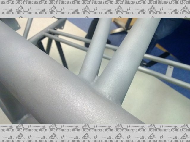

I went to the Niche Vehicle Symposium today for work, at the Gaydon Heritage Centre. A really interesting day, with talks from all manner of companies, including Morgan, Caterham and Ariel as well as plenty of EV and HEV suppliers. Some great innovation on show, but what really caught my eye (and made for an excellent presentation) was the titanium Ariel Atom chassis. Anyone who knows titanium will know just what a nightmare to make this would have been - they claim it was welded in the worlds largest argon inert chamber - effectively a large clear pressurised tent, with 36 access gloves to weld inside so as to ensure a high quality, not brittle weld.
The cost and development required was frankly crazy, but I do love the engineering and thought that has gone into it for a 30% weight saving, and an increase in torsional stiffness (larger diameter tubing to make up for the lower modulus of titanium)....
Ariel atom hi res 2
Ariel atom hi res 2
Ariel atom hi res
Ariel atom hi res

I bet the argon tent cost a pretty penny to purge and fill! A real money no object build
twybrow
posted on 20/3/13 at 06:47 AM Reply With Quote
Originally posted by indykid
That's cool!
750,000 litres of Argon! :O

Sorry to be the one who pisses on their firework, but maybe they'd have been better off investing the money in a properly triangulated spaceframe, or possibly a stressed tub to sit within their cosmetic climbing frame instead of an abortion with effectively pre-buckled, curved main tubes?

Curved tubes are going to give you lousy stiffness, period. They are, as I suggested above, effectively 'pre buckled', in that if you put a compressive or tensile load onto either end, it results in a bending force in the tube itself.
Even ignoring the crash photograph, there's a long list of design shortcomings with the Atom's chassis, staring any reasonably competent engineer in the face.
...But the photo does show an absolutely classic and predictable failure, where the large diameter (but curved) upper main tube has folded over the much smaller (but straight) triangulation at the front bulkhead position... it's done exactly what any first year structures student would have predicted it would do.
It's pretty much like folding a cardboard tube by bending it over your knee - you couldn't come up with a better way to make it fail if you wanted to.
