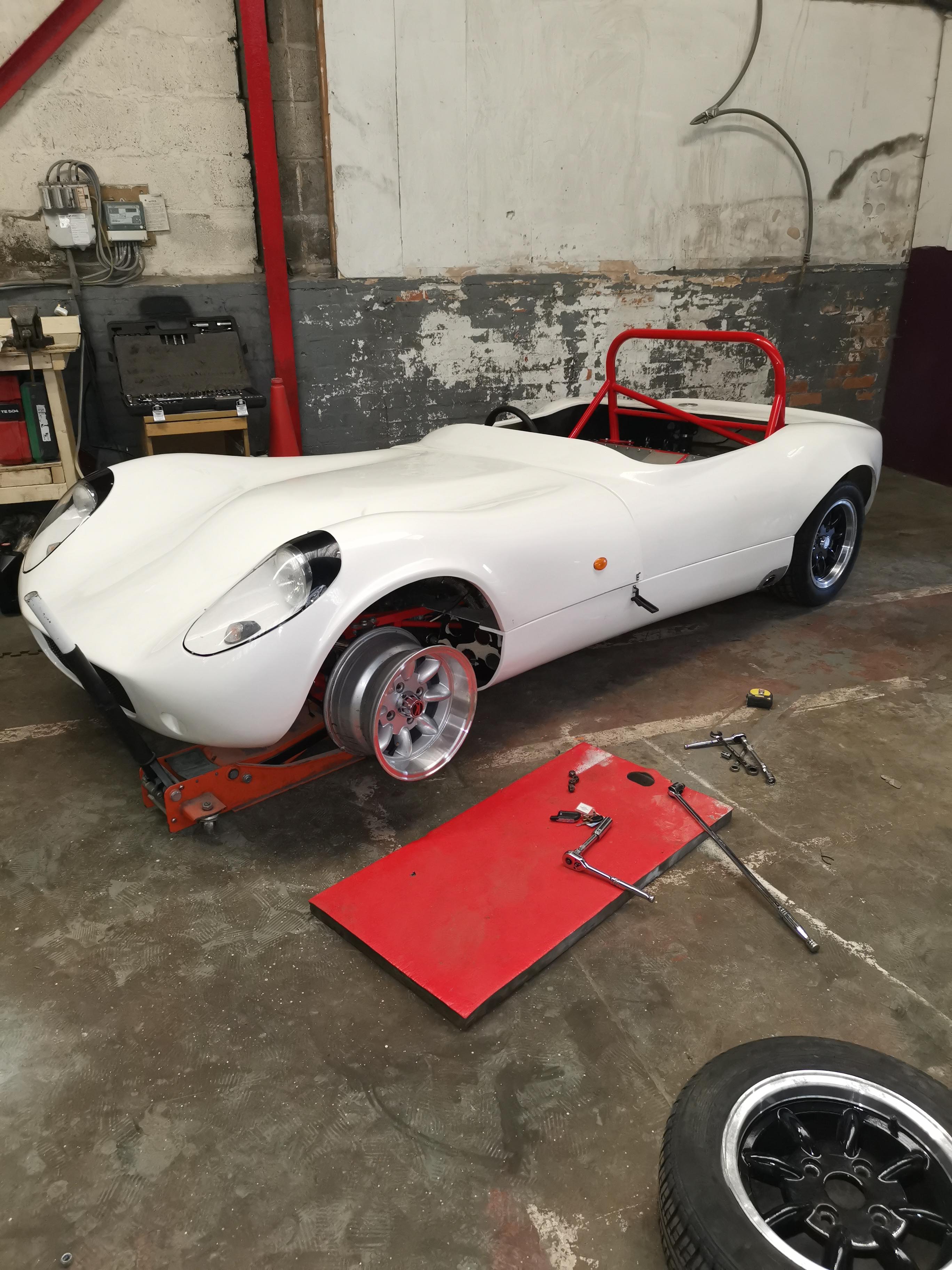

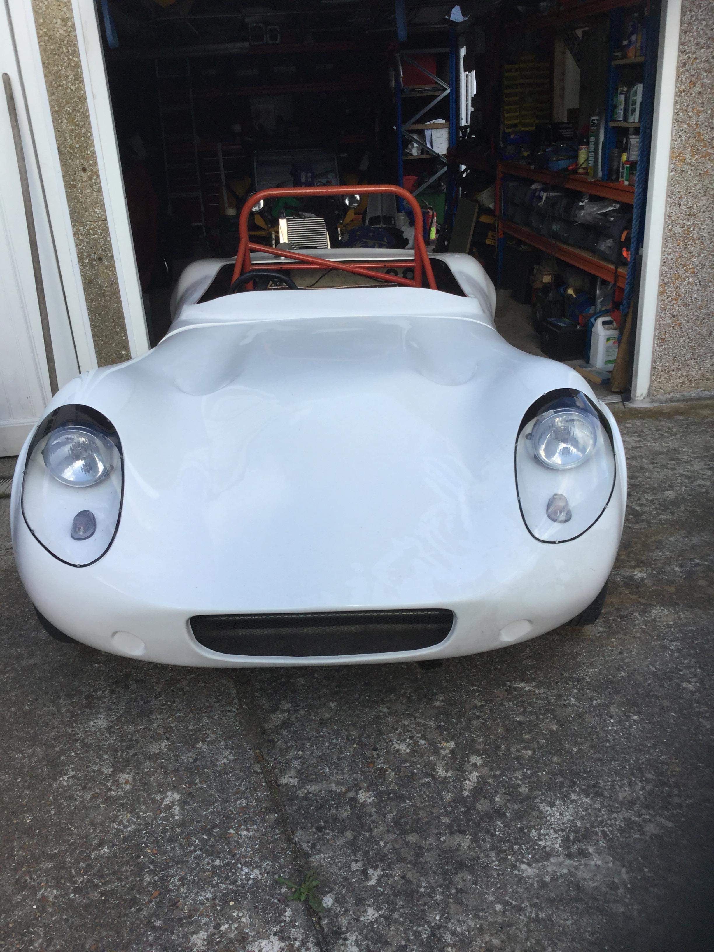

So I've recently bought a Fisher fury with a fire blade engine 90% complete. I'm looking to put it through an iva test next year fingers crossed.
Jobs to be completed for Iva test
• stamp chassis number & fit chassis plate
•electric reverse
• clip throttle & clutch cable ✔
• renew dashboard (switches as well)
• fit mirrors
• nut&bolt covers
• track rod end covers
•Handbrake light switch✔
•low brake fluid switch✔
Other jobs:
Service engine
Longer wheel studs
Re pipe coolant to radiator
Make windscreen
Fit seats & harnesses
Here's some photos of the car, if anyone else can think of anything that needs doing for the iva test feel free to comment, I will be having a good read through the guidelines. Hoping to take it on track this summer😜
