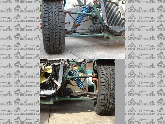

Joel asked about this a while back. I've never felt the effect you are talking about with my car. When I built it I had my own theory that the track rods should be parallel to the bottom wishbones to help combat the bump and so I mounted it lower than the book measurement and my brackets also set it a bit further forward. Rescued attachment rackpos.jpg
