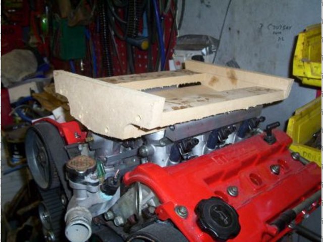

I start with a sheet of 18mm MDF and cut out the rough shape , filling in the larger flat area's is easy this way - all glued and screwed together so it holds it's shape when power sanding .
Stage 1
Stage 1
Stage 1 and a bit
Stage 1 and a bit
This it with the first stage of filler applied
First filler
First filler
This method leaves me with a former that can be used to make a mold , but is tough enough to be used as a tool to make the finished component as well - allso it is very fast
Edit - I forgot to add it's important to make sure the former is tapered on all sides when making a one-piece mold (2 to 3 degrees is enough)

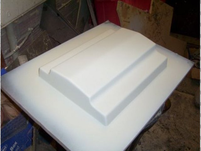

Allmost ready for paint now - it will get a couple of coats of a polyester based spray filler , after being mounted on a board (to keep it flat , and make handling a lot easier)
Shape finished !
Shape finished !
This is how it will sit on the engine - next bit to make is the inlet tube which will be on the front but bonded on separately as I plan to have the shiny side on the inside , and adding it now would make the molding impossible to remove from the mold .
Why it's this shape....

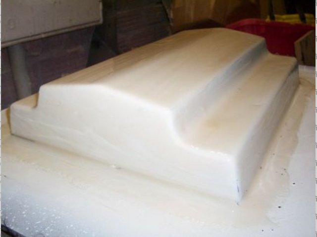

Here is the former finished - a bit of filler , and some elbow grease later........
It has had a few coats of polyester based spray filler (couldnt use the high gloss finishing paint at work - it had been sat in the cupboard too long )
Painted former
Painted former
Next stage is to smooth it off with some 1200 grit wet`n`dry - this will leave a very smooth near gloss finish to the mold which will easily polish to a high gloss with a bit of Tcut .
Yep - I've decided to make a mold rather than mold straight off the former - more pictures to follow later today

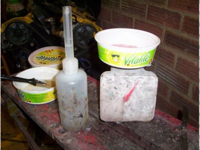

With the former smoothed off , next to come is a couple of coats of wax . I use `Mequires Mirror Glaze` - not cheap , but it is very good (and a tin last's me years )
The gel coat resin go's on next - I mix the hardener in by weighing the resin , since 1 litre of resin weighs a kilogram , I add 2% hardener .
A handy catalyst dispenser is cheap enough - so for the 200cc's of gel , just 4cc's of catalyst .
The tools.....
The tools.....
This mix is then painted smoothly over the former - it is best not to have any run's or sag's in the gel as this can lead to air pockets in the mold

Peteff
posted on 16/5/09 at 04:23 PM Reply With Quote
Good old Vitalite tubs, where would we be without them ? I cook stuff in them. you can microwave them you know. I've got a half finished mould for a rear wing that I'm going to have a go at later ( much later ) and I'm not sure whether to make it like this or take one from it as a negative if you know what I mean.
yours, Pete
clairetoo
posted on 16/5/09 at 05:17 PM Reply With Quote
Disclaimer - other margarine tub's can be used

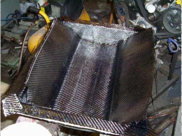

The mold got a light coat of gel while I cut the carbon mat (and a bit of coremat for some heat insulation)
Here is the first section of carbon going in - cut to fit , and drowned in resin to reduce the chance of air bubbles .
First layer of carbon
Repeat on the ends , then add a layer of coremat where it is close to the engine (to stop a bit of heat)
Cormat heat insulation
Due to the shape of the mold , the cut pieces of carbon mat have to be fed in and wetted out from the centre out , being very careful to fit the mat to the corner's .

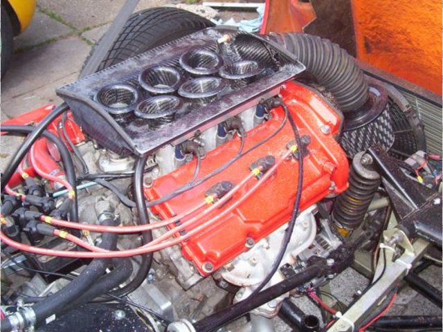

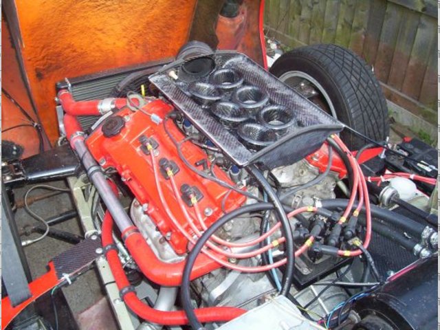

OK OK - no need to keep on at me - here , at last , is the long awaited update ! !
That first one came out of the mold OK , but with so many other jobs to do on the car it kinda got put to one side (and added to the `to do' list....)
First job was to cut the holes for the throttle bodies , this was done by applying masking tape , then simply pressing in place on the `bodies .
The resulting `marks' are then drawn in in pencil and cut out with a die grinder .
Fitting started
Fitting started
So it then fits like this
In place
In place
The trumpets are then bonded in place with a little P40 (with a spot of black fibreglass pigment added to lose the red colour) , and the top of the box trimmed to fit the bonnet bulge . A hole was also cut in the front of the `box , a piece of ally sheet cut and rolled to shape and taped in place , and the inlet stub molded in place to take an inlet tube (from a Mondeo !) fitted , to fit an air filter on .
Trimmed to shape
Trimmed to shape
rear left view
rear left view
It seals to the bonnet so no lid is needed
[Edited on 14/7/10 by clairetoo]

smart51
posted on 14/7/10 at 09:29 PM Reply With Quote
Nice job. I like the idea of sealing to the bonnet too. You get the most headroom over the trumpets without having to have a bulge.
