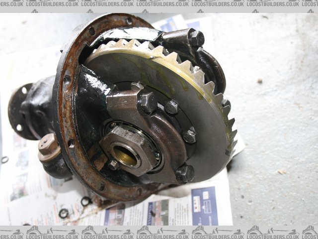

As previously reported, the diff had already been restored, but I also took that apart again and put in a modern lip seal where the prop shaft flange is.
