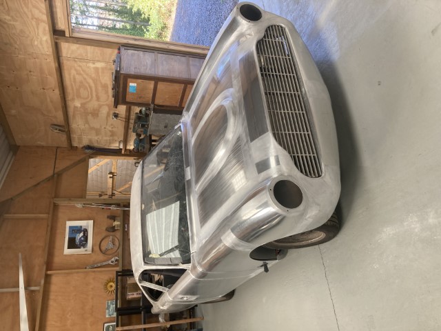

posted on 5/7/23 at 10:40 AM Reply With Quote
It's been a while since my last offering but progress has, of necessity, been slow but progress nonetheless.
The grille is now finished and I'm really pleased with the result. It was simple to construct but in my opinion is effective. The slats are aluminium flat bar separated by 6mm o/d stainless steel tube spacers. 3mm studding passes through the centres and clamp everything up tight. The photo shows a simple jig I made to ensure all the spacers are the same length.
https://i.ibb.co/NnJmVkY/IMG-4581-Small.jpg
Start up was delayed by a fault in the ecu and a problem with the loom but everything was rectified free of charge and the great day arrived when the car moved out of the workshop under its own power.
A very short video to mark the event. The crash right at the end is the neighbour who was reversing her car while looking at me and crashing into a flower planter.
https://www.youtube.com/shorts/Y-V81lcGAlg
