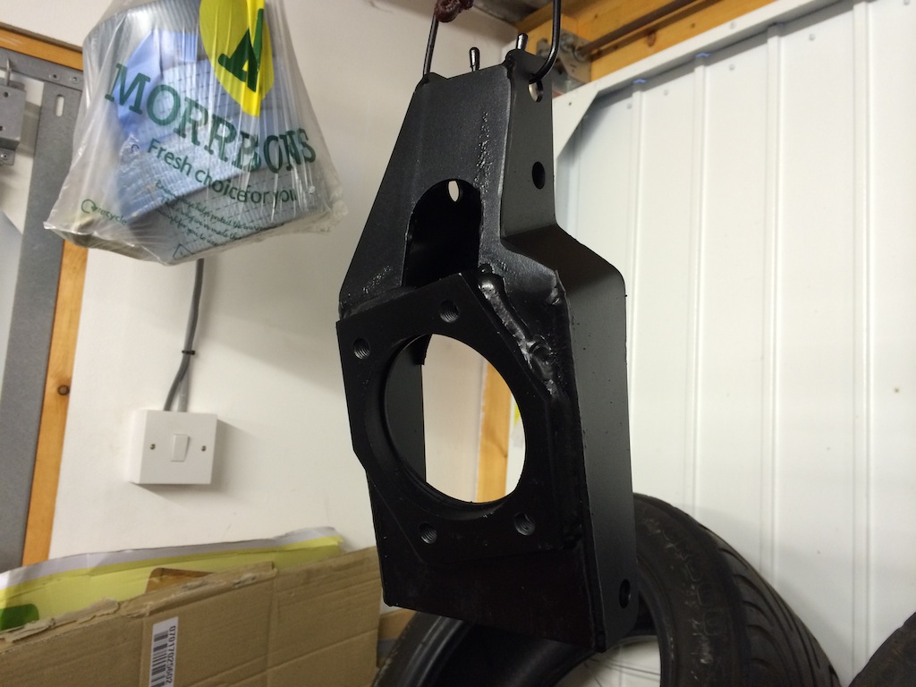

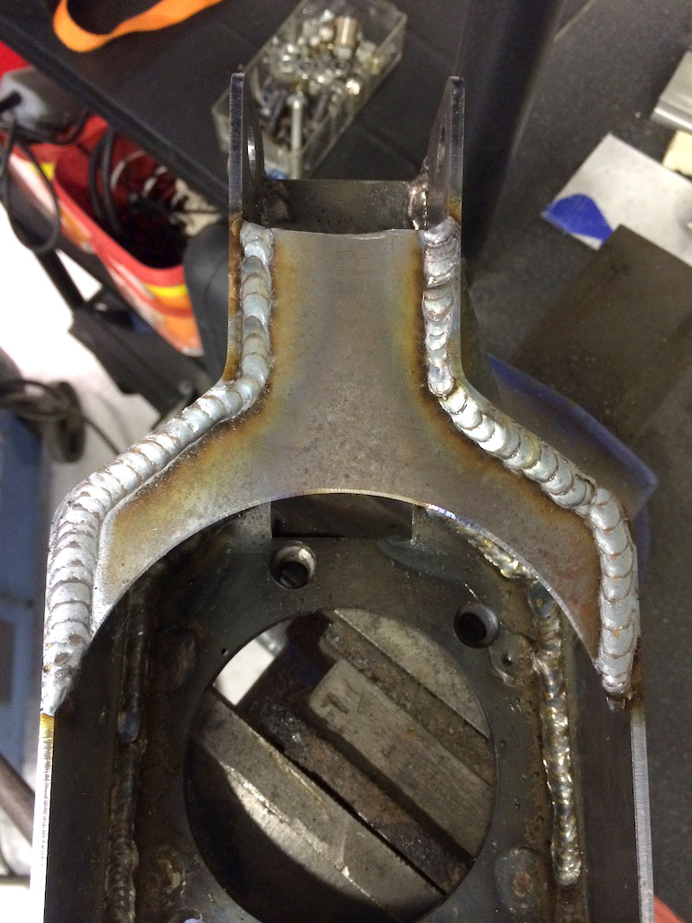

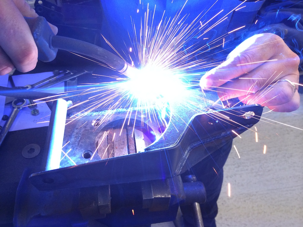

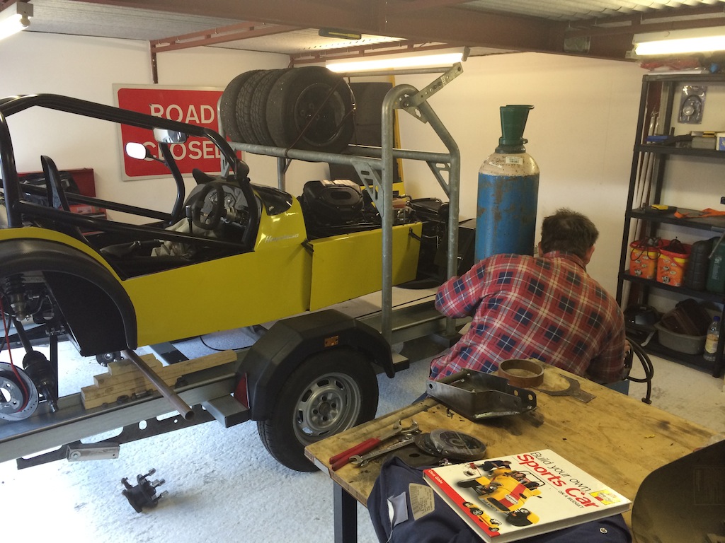

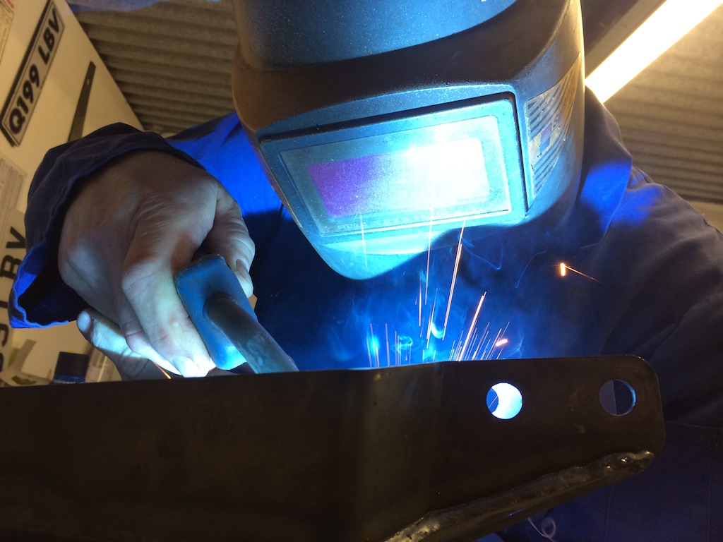

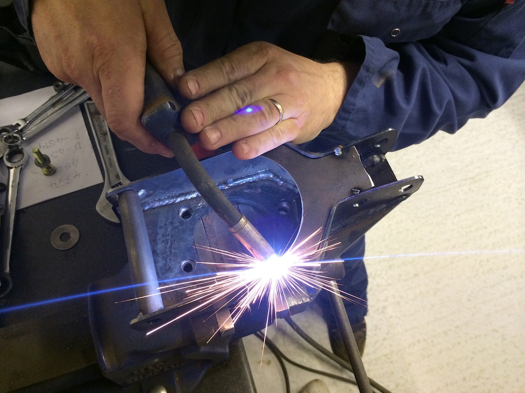

So Steve Bell (Stevio73) made the trip down from Selby today to reinforce my new uprights for me, to be sure that no bendage goes on again, to which we strongly believe it'll no longer happen
Huge thanks to Steve - his knowledge & fabrication skills are second-to-none, a very clever chap in deed!
Steve at work
Gussets welded in (cracking welding imo) - now try and splay out ya bastards!
All painted up ready for refitting

So theres nothing wrong with my welder then!
Nice job BTW :-)

yellowcab
posted on 23/3/14 at 07:07 PM Reply With Quote
We didn't use your welder Col'
90amps just isn't enough for 3mm, Steve's was a 155amp

I really wish I could consistently weld that neatly. I get it to look that good maybe 1 in 3.

I believe that slicks play a huge part, as they offer too much grip in some cases. (the lateral G force)
For instance, I don't believe this would happen on road tyres, or 888s, as you'd break traction before you start to bend metal (imo)
But either way… strengthening the uprights will just locate where the next weak spot is - probably the 10year old chassis lol
Come winter - I'll have a new chassis to transfer everything over onto
