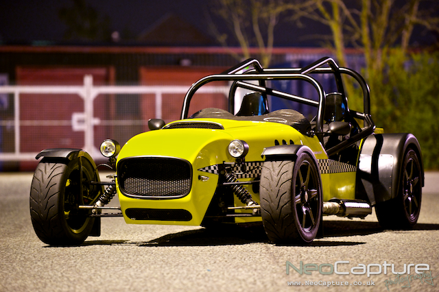

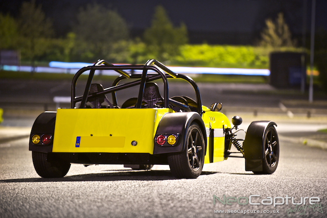

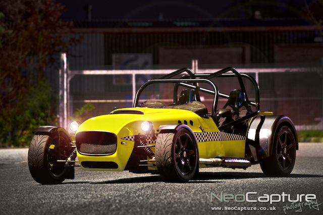

posted on 2/5/12 at 11:32 PM Reply With Quote
Got bored tonight so decided to pop out to take some photos...
[Edited on 2/5/12 by yellowcab]

Awesome pictures Olz, can I book some lessons please???? Your car looks great!
snippy
posted on 3/5/12 at 08:35 AM Reply With Quote
Looking at the 2nd photo above it looks like you`ve fitted eyelashes to your headlights! Then I realised it`s just the circular bonnet vents in the back ground. Have a look you`ll see what I mean
[Edited on 3/5/12 by snippy]
yellowcab
posted on 3/5/12 at 01:18 PM Reply With Quote
haha totally see what you mean, oh it does look very feminim!
I'm up for doing a shoot on anyone's car if they're up for it...
Let's hook up and I'll show you the ropes
