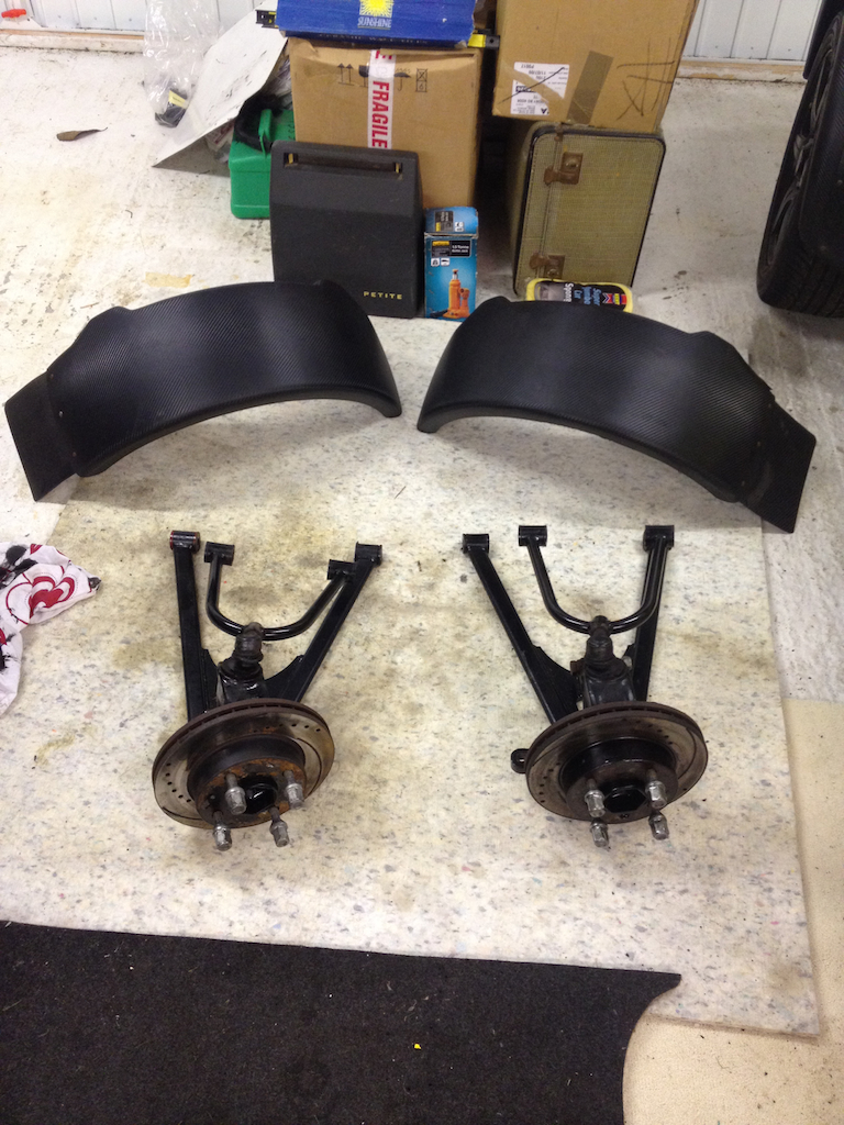

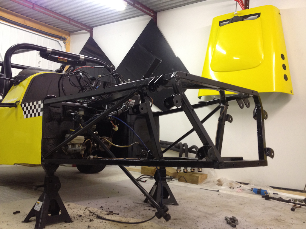

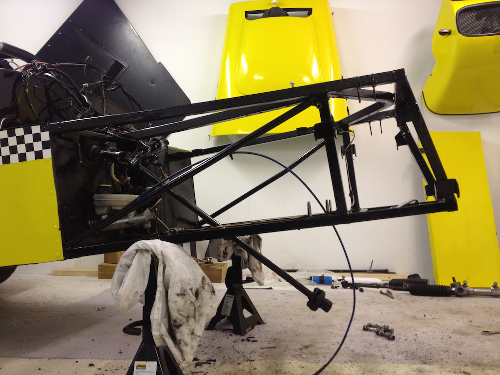

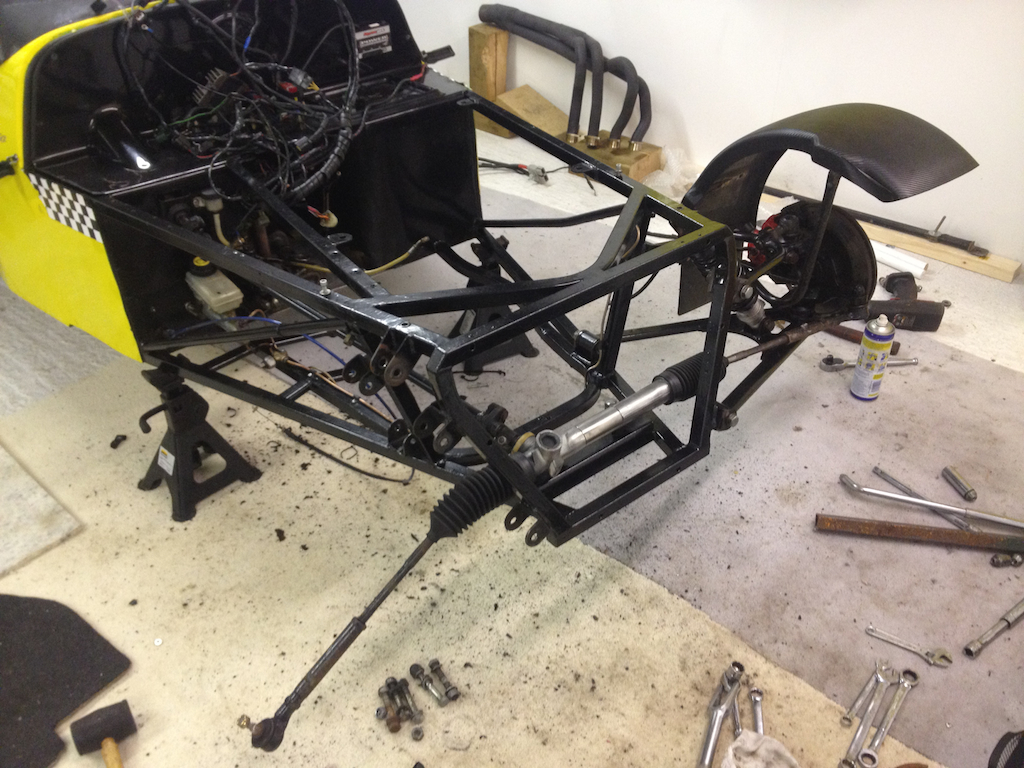

Went down the garage again for a couple of hours, stripped the rest of the front end of wheels, suspension, arms, brakes, steering rack etc so I could continue refreshening up the chassis
Not very interesting, but pics nonetheless
One side gone
Couldn't split the hub carriers, from the arms for love nor money - so I removed them as is... however I do need to get the brake disks off, as I'm replacing them - any tips anyone?
Freshen up continues, all mounting points now painted, and second coat applied to rest of the chassis
That's all for now folks, any help and advice in splitting the fronts would be greatly appreciated lol

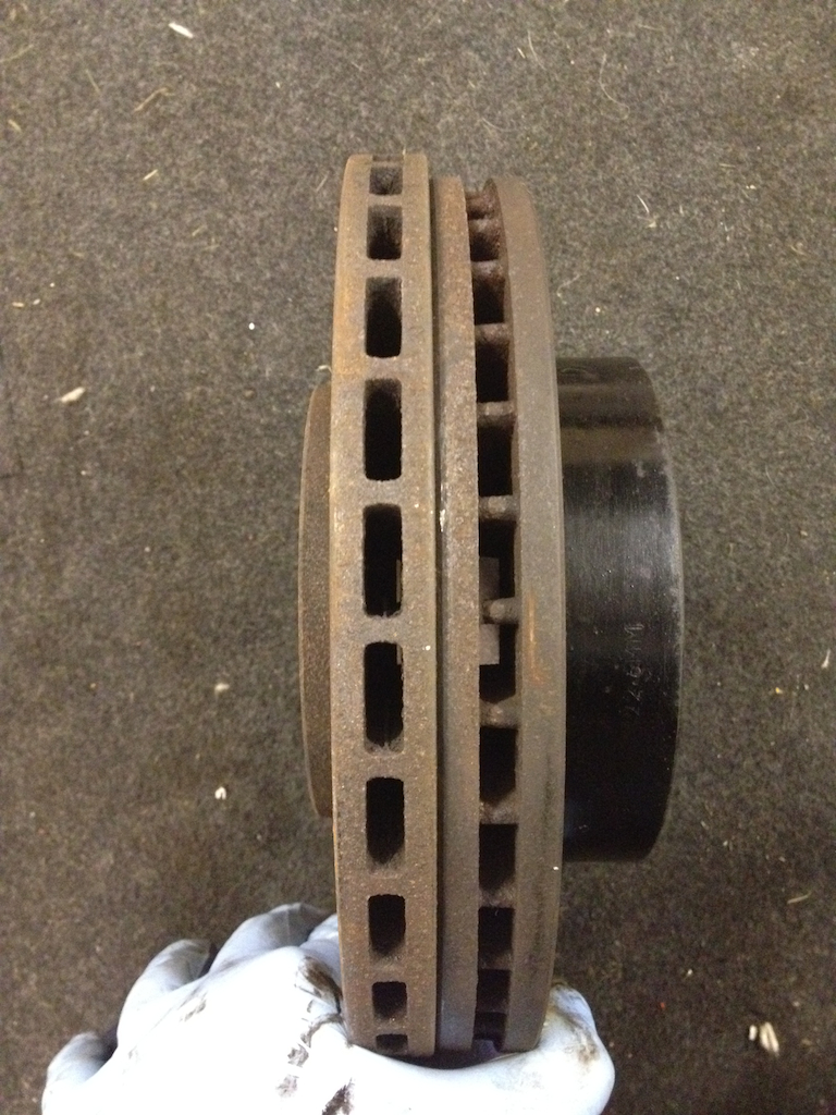

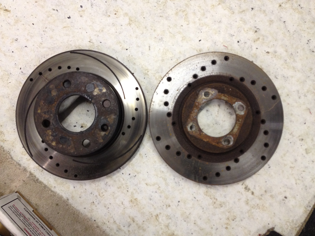

Got the disks off, just used a rubber mallet...
Had my new replacements out the box that I got from Jon, and it seems that they're wrong stud pattern... the holes for the wheel bolts to go through are tiny, and also look like 4x98, as opposed to 4x108, so looks like I'll need new disks...
Would use my current disks, but they don't fit in between the jaws of my Wilwood calipers - grrrr

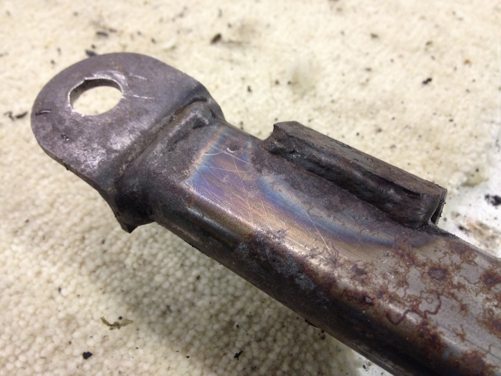

Old disks off
New disk on left, old on right... ohhhh
Old disk thicker, and also hub carrier part deeper
PCD well off, and smaller holes

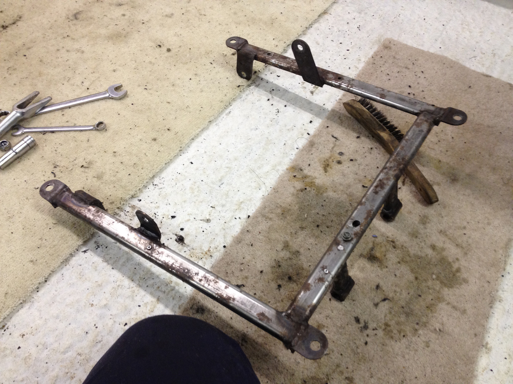

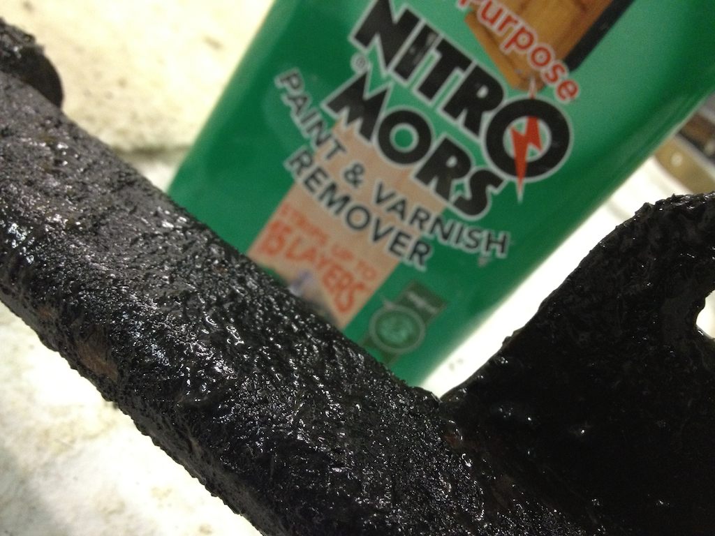

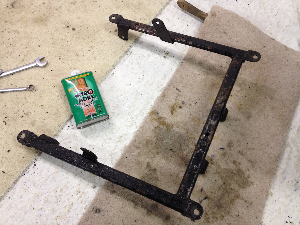

On a brighter note, Nitromors'd the engine cradle, its awesome stuff
Done
Final coat applied
[Edited on 25/1/13 by yellowcab]
